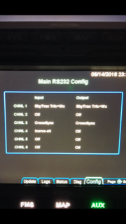

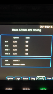

Posted By: teeth6
Date Posted: 13 Jun 2018 at 1:41pm
Where can we find the 429 and 232 settings?  Is this something our installer has to provide or can they be found in maintenance mode on certain configuration pages?
Posted By: AviSteve
Date Posted: 13 Jun 2018 at 1:49pm
Go into maintenance mode, config tab.  The first two pages are Main 429 and Main 232, respectively.
Steve Lindsley
Avidyne Engineering
Posted By: AviSteve
Date Posted: 14 Jun 2018 at 9:01am
Originally posted by AviSteve AviSteve wrote:
...it appears that the image upload is broken again and I'm working to get that resolved.  So, unfortunately, you'll have to just post your settings using text for now.
I got the image uploads working last night, so you can post pictures of the config screens if you like.
Steve Lindsley
Avidyne Engineering
Posted By: teeth6
Date Posted: 14 Jun 2018 at 8:52pm
This is the 232 page and I'm in the camp that does not see the "banana" on my IFD100.  I'll post the 429 image next.
Posted By: teeth6
Date Posted: 14 Jun 2018 at 8:54pm
This is the 429 Config page.
