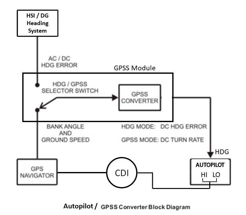

I went back to read my STEC 30 autopilot and ST 901 GPSS converter manuals, and neither mentions needing to go to Hi Trk mode to shoot an approach. In fact, both show examples of various approaches (LOC and VOR) and use the HDG mode (or GPSS + HDG in the case of the ST 901 manual). They explain the greater authority of Hi Trk vs Low Trk, but when they show examples of using approaches, they don't use those modes.
From what I can tell, the autopilot can use inputs from the HDG indicator (which the GPSS emulates) or the CDI/LDI/VDI. The latter are used when you go to one of the Trk modes. However, the approach examples seem to always rely on the HDG mode of the autopilot.
In my experience, the autopilot keeps the CDI centered very well. The IFD-540 switches to the right mode (say VLOC for an ILS) and shows deviations from the glide path and course. I assume it is indicating information from the NAV radio, not the GPS, when in that mode. Thus as long as the needle is centered, it is on the correct course, regardless of what signal the AP is using to stay there. As long as I monitor the CDI, I'm following the right path and the sensitivity of the needle changes as needed at various points.
I understand I shouldn't rely blindly on the GPS position, but if the CDI is correct, I can keep going on my merry way. No?
Is there something I'm missing? Would the GPSS switch that changes the input to the AP from the HDG system to the GPS navigator also affect the IFD-540 and cause it to drive the CDI differently?

my STEC 30 AP doesn’t switch anything automatically. It can do three things: keep the airplane stable (a wing leveler that can turn), follow a Heading Input (from a Directional Gyro or the GPSS Converter) or follow the indication of a CDI (with weak or strong authority - Lo Trk or Hi Trk). The modes have to be manually set.
The GPSS device (an STEC ST-901) connects to the AP through a switch. The switch is on the panel and needs to be manually pressed. It selects between the DG or the GPSS box. I don’t know if the OFD also gets the state of the switch.
The GPSS device manual describes shooting approaches and in all cases, the AP ends up using HDG mode to follow the path it needs.
The IFD-540 is connected to the GPSS device and to a Garmin GI-106 CDI that indicates the glide path and the course deviation.
When shooting an ILS, the IFD will switch to VLOC mode automatically and the GI-106 will provide appropriate indications based on the ILS.
So far, I’ve been keeping the switch set to GPSS. The AP maneuvers to get on the approach course. Eventually the IFD switches to VLOC mode, and I follow the glide path down manually, with the AP keeping the CDI centered. I do not Switch off GPSS and switch the AP mode to Hi Trk. The latter is what I would use of I didn’t have GPSS and I were following a glide path from a NAV radio. The GPSS seems to do a pretty good job of keeping the CDI centered.
Kentucky Captain has the Aspen performing the function of my ST-901, along with other functions. In his case, there seems to be a problem inside the FAF, so he has to turn off GPSS and tell the STEC-30 to follow the CDI using Hi Trk mode.
I want to make sure I’m fully legal and don’t misunderstand what is happening in my plane. I need to understand the IFD-540 operation to make sure it is properly driving the CDI with the required sensitivity. I appreciate the inputs so far. It has been very educational.

The STEC-30 doesn't have an APPR mode. It only knows about a heading source and a CDI.
There are four selectable settings:
1. ST - Stability mode. Essentially a wing leveler.
2. HD - Heading mode, from the time a DG with heading bug would feed it an error between the heading and the desired track
3. LoTrk - Low authority tracking. Follows the CDI with some damping so it doesn't respond fast to an error. Used to follow a VOR signal.
4. HiTrk - Hi authority tracking. Follows the CDI just like LoTrk, but responds more quickly to any deviation. Used for a LOC or ILS signal.
There is also a separate Altitude Hold function that tries to maintain the pressure altitude recorded when you press an ALT HOLD switch. If the plane is not trimmed properly, it indicates to add UP or DN trim and the pilot must do this manually.
Here's a block diagram:
The ST-901 GPSS box connects only to the HD input of the STEC-30. A panel-mounted switch selects between feeding the deviation from a heading indicator or a deviation derived from the GPS signal.
Here is a block diagram from the ST-901 manual:
Here are the instructions for flying a GPS approach from the ST-901 GPSS Converter manual:
I do not have an Aspen manual, so I don't know how the STEC-30 is connected to it and the IFD-540. It may be the Aspen provides both the CDI and DG signals or it might be it only provides the DG signal and the CDI is from the IFD-540.
I was thinking, perhaps naively, that the Aspen had the equivalent of the of the ST-901 inside. In any case, the STEC-30 only knows it is dealing with a HDG Error when it is in HD mode or a CDI deviation when in xTrk mode.
I understand why it is best to switch to HiTrk to correct any CDI deviation. That signal should be more accurate than the HDG Error.
What I don't understand is why a similar electronic setup inside the Aspen would, all of a sudden, command a turn 1 mile from the FAF. The description that Kentucky Captain provided was that the STEC-30 was in HD mode and GPSS was engaged. The Aspen would be providing a heading error as it goes along. Perhaps this error signal is not as sensitive as the CDI, but still, why would it suddenly change to make the AP turn fairly far down the approach path?
Posted By: chflyer
Date Posted: 17 May 2018 at 12:26pm
Originally posted by HenryM HenryM wrote:
I still am unclear about the following:
1.) If I switch GPSS on (in my case a panel switch for the ST-901 GPSS box), does it make the Avidyne IFD-540 drive the CDI differently than when GPSS is off? I believe the Avidyne is still using the NAV radio signal when shooting an ILS or tracking a VOR, but I am not sure. I also don't know if the sensitivity of the CDI indication is changed as I get closer to the runway, just like it would with the GPSS switch off.
In other words, if I leave GPSS turned on, but switch the STEC-30 to HiTrk, will the CDI signal that it uses in that mode be more sensitive as I get closer to the runway?
I don't have an Aspen, and can't comment on its connectivity and/or behaviour. In the case of a STEC ST-901 GPSS converter, there is a switch that is always active indicating either GPSS or HDG. It is the STEC-30 setting that determines if the GPSS converter comes into play. If the STEC-30 is in any mode other than HD mode (e.g. TRK HI), then the GPSS converter is decoupled and plays no role in AP behaviour, regardless of the setting of the switch (GPSS or HDG).

Posted By: Bob H
Date Posted: 22 May 2018 at 1:06am
This is an interesting discussion on how systems interface and how they should be used to fly an approach, especially precision approaches.  For my own understanding and learning, I’ve summarized some of the information from this thread combined with my own thoughts of how things work.  Please let me know if there is any disagreement.
1.       The IFD never knows what state the autopilot is in, i.e. HDG, GPSS, NAV, APPR, HI, LO, etc.
2.       GPSS only functions when the autopilot is in HDG mode.  If HDG mode is not active, then it makes no difference what state GPSS is in.  Therefore, if the autopilot is in HI TRK mode, turning off GPSS will have no effect on anything.
3.       Nothing external to the IFD will affect or change its CDI sensitivity.
4.       The IFD GPSS can only output enroute CDI sensitivity.
5.       A coupled precision approach should only be flown in APPR (HI TRK) mode inside the FAF.
Any corrections?

Posted By: HenryM
Date Posted: 22 May 2018 at 8:14am
In HD mode, my STEC-30 AP follows whatever heading error is provided by the Heading system. This signal can come from a Directional Gyro with a heading bug, or it can come from a GPSS system. The CDI is not the source of the error signal.
The CDI is the source of the error signal that tells the AP to turn when the STEC-30 is in TrkLo (NAV) or in TrkHi (APPR) modes.
Posted By: Bob H
Date Posted: 22 May 2018 at 8:45am
That is how it works in my setup as well.  Here is a modified diagram from Page 1 of this thread.  When the AP is not in HDG mode, the HDG/GPSS signal does nothing.
