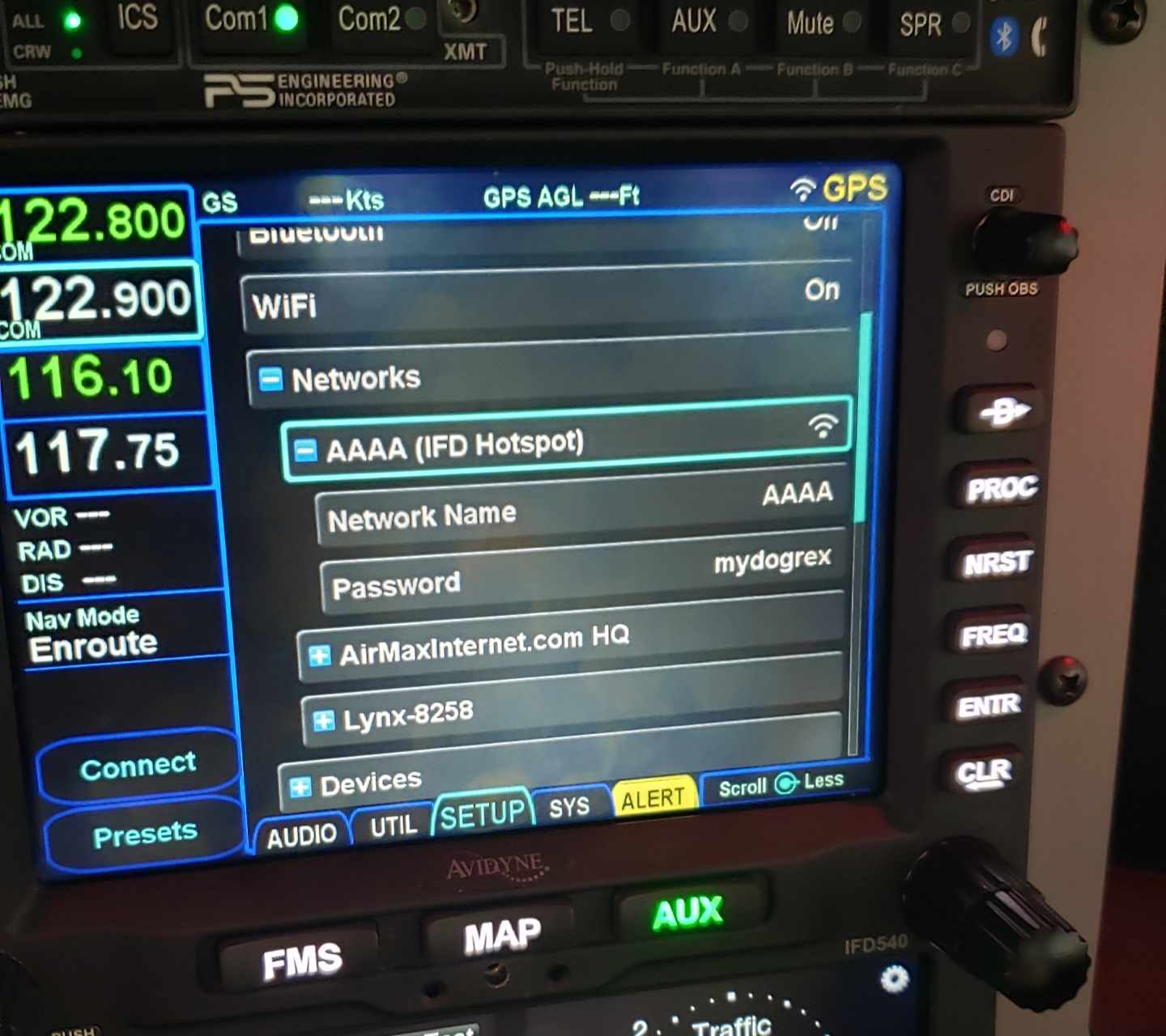

Config page - Wireless Portables = Capstone = ENABLED
after reboot:
Go to AUX page, SEUTP, WiFI = ON,
NETWORKS = STRATUS network CONNECTED
DEVICES = allow IP address to ALWAYS.
Kurt

Prior to 10.3, you had to set up the WiFi configuration options in Maintenance mode.  You could set up a "local" network where the IFD established the network and clients connected to it, or a "remote" network to which the IFD could connect.  Back in flight mode, however, you had to choose one of those options.  it was never the case that the IFD was in both "local" and "remote" mode.
So on the Display Setup page in your 10.2.x.x IFD, did you have local network (e.g. LIO_WIFI) selected or did you have a remote network selected?  I'm guessing you had a remote network selected and that network was hosted by your SkyRadar.  If that's the case, then with your 10.3 IFD, on the Setup Page under the Networks category, you should see the network SSID being broadcast by the SkyRadar.  Scroll to that network, then press the "Connect" LSK.  Once the connection has been established, you can connect FlyQ to the SkyRadar SSID.  At that point, you should be able to transfer flight plans, etc. between the IFD and FlyQ and FlyQ should get ADS-B data from the SkyRadar.  As an additional benefit with 10.3, the IFD can also display the ADS-B in data from the SkyRadar.
If I don't have the assumptions right or if that's not working for you, let me know either by reply post or PM.

It is asking for my stratus password. Where to I find that?
edubes
Posted By: AviSteve
Date Posted: 07 Sep 2022 at 10:08am
What's asking for a Stratus password?
I'm not sure if this is true for all Stratus boxes, but whenever I've connected the IFD to a Stratus network in our lab, the Stratus network has no password.
Steve Lindsley

Another issue: on 10.2 I had a blank password for the Wi-Fi on the IFD540.  10.3 won’t allow that.  It seems to need at least an 8 digit password.  Any way around that?
No sorry.  Cybersecurity and all that.  "password" is 8 characters :)
Yeah, because someone is gong to compromise my IFD as I fly over.  Hi Steve.  Does 10.3 fix the issue we discussed about flight plans uploaded from Foreflight not being able to enter a procedure because it didn't recognize the last fix as a destination?  I only had a 20 minute flight back home from the upgrade and I was busy checking out everything else and forgot about it.
Woo Hoo!!!
this is concerning --
so 10.3 cannot connect to an open wifi network?
yes it can connect to an open Wi-FI network, I connected it to a StratuX box that wasn't using Wi-Fi Security and it worked fine, just leave the password field blank.
I did not however test to see if the IFD can create a Wi-Fi network without a password.

Have a new problem with 10.3 upgrade. According to config page and info on the 540 the upgrade is installed but I am getting a “ no 429” error alert. Went through all config pages with no success.  Also, multi engine fuel page does not load correctly. Have been through many discussions with tech support. Have IFD 540, dual Aspen Max and Garmin 345 xponder. Any suggestions?  Thanks, Phil ( Baron N450CF).
Posted By: RobK
Date Posted: 01 Oct 2022 at 2:25pm
Updated IFD540 to 10.3 today, no errors, all settings carried over. I have the users and connectivity items setup  correctly but have no SSID that is being broadcast from the 540 unit for the iPad to connect to. Here is the connectivity screen shot. I renamed the default network name to AAAA to see if it would make a diff. No change. The wifi icon is on but no ssid.
I own a wireless internet ISP company and am well versed in WiFi. I ran our spectrum analyzer and nothing is being broadcast from the 540 unit.
Any insight would be appreciated.
Posted By: PA23
Date Posted: 01 Oct 2022 at 2:37pm
I think you are over analyzing the situation. :-)
The image you posted shows that the Wi-Fi is turned on but not ready for use, try pressing the "CONNECT" LSK, I believe that will initialize the WiFi Network.  After that I believe the IFD will use the last network selected.
-PA
Posted By: RobK
Date Posted: 01 Oct 2022 at 4:25pm
Thanks PA -
But… unfortunately not over analyzing. I can use connect and connect to a Wi-Fi network, but the unit is not broadcasting any SSID or Wi-Fi signal for the IFD Hotspot, even after pressing connect for the IFD hotspot.
When I press connect for the IFD hotspot, the animated Wi-Fi icon flashes 7 times then goes solid white as it was before pressing connect.
It’s as if my Wi-Fi hotspot capability is not enabled. Wifi and BT show enabled in software status page as expected.
Kind of strange to have “connect” when it’s really “enabling” the hotspot which disconnects anything the IFD is connected to as a client.
Posted By: RobK
Date Posted: 01 Oct 2022 at 5:05pm
Downgrading to 10.2.6.1 until they fix all the issues in this thread. Considering it’s purpose it should have been a very vetted and clean update. Needs to work out of the box.
Posted By: RobK
Date Posted: 01 Oct 2022 at 6:11pm
Downgraded to 10.2.6.1 LIO_WIFI not coming up. Something in the 10.3 upgrade broke the Wi-Fi hotspot or wiped out a key that enables it.
Any insight Avidyne Team?
I guess I’ll email and call support on Monday.

Posted By: RobK
Date Posted: 01 Oct 2022 at 6:48pm
Spoke too soon LIO WFi came up in 10.2.6 after the downgrade from 10.3. Took about 10 min to go green but it’s back.

Posted By: RobK
Date Posted: 05 Oct 2022 at 11:08am
Steve - Are you looking into the issue of IFD hotspot not functional after 10.3 update? Just goes away, no broadcast of SSID or any frequency coming out of the box. I downgraded to 10.2.6 and the hotspot is working again.
Posted By: AviSteve
Date Posted: 05 Oct 2022 at 1:55pm
We're not actively looking at that.  Yours was the only case I heard of where that happened.  Seems to me that it was something with the LIO apps processor, but can't tell now that you're back a release.  Before you reverted to 10.2.6, did you ever contact tech support regarding the problem?
Steve Lindsley
Avidyne Engineering
Posted By: RobK
Date Posted: 05 Oct 2022 at 1:59pm
I sent an email last week but it was hurricane week and then reading the issues here, I decided to revert. Subsequently, tech support replied asking for log files as the wifi module could have gotten corrupted. But all the logs are gone since reversion
I'll wait until the other bugs are worked out and try again at that time.
