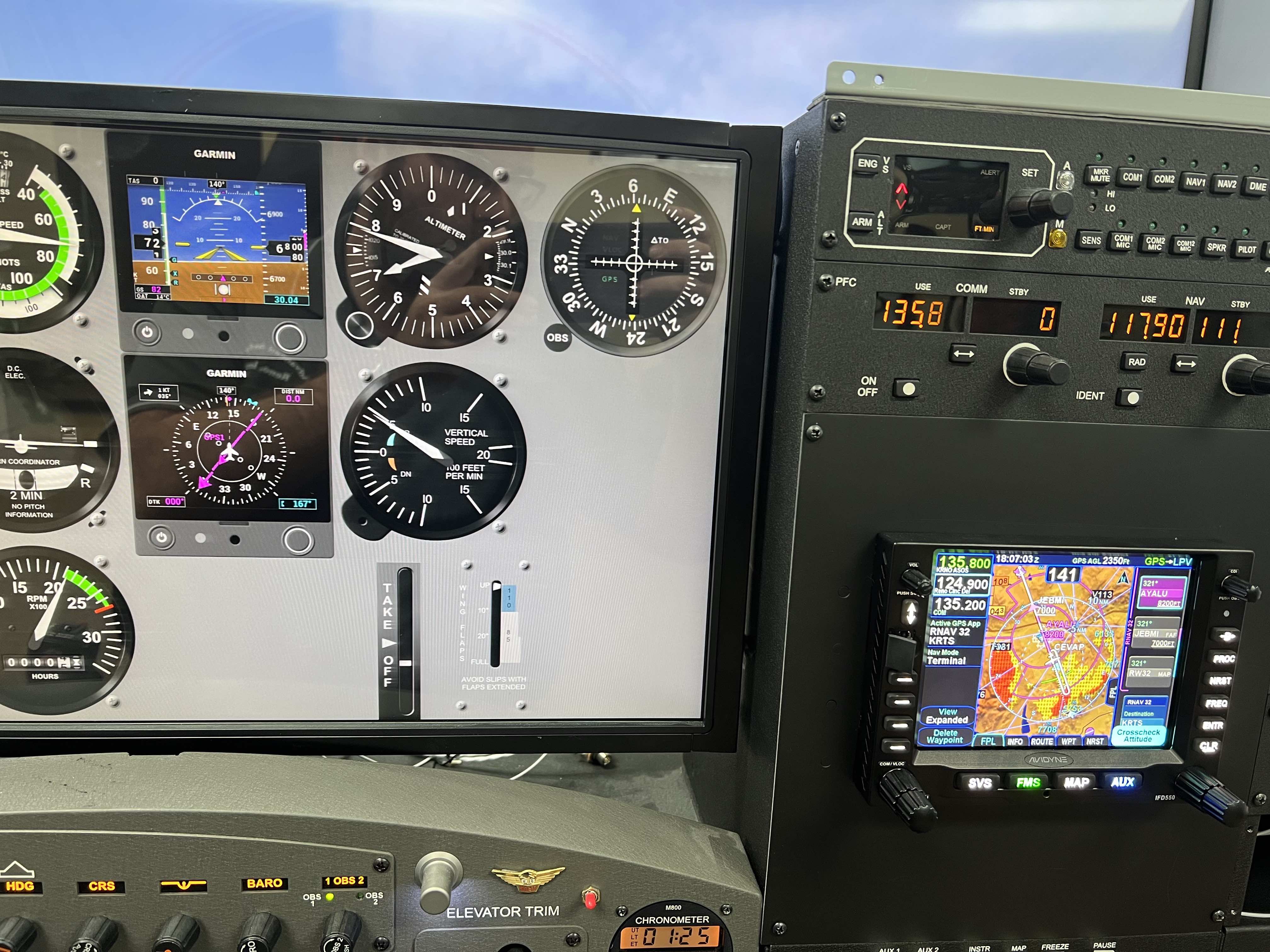

I use airmanager for the other instruments (and a knobster) .. the IFD Trainer XP runs on an ipad mini
I tried a few screen sharing apps to see if i could get IFD onto one of my touch panel monitors, but nothing worked better than having it on the ipad.
i am using a RAM mount on the edge of the desk so that the ipad sits between the yoke and the throttle quadrant .. so it works well.

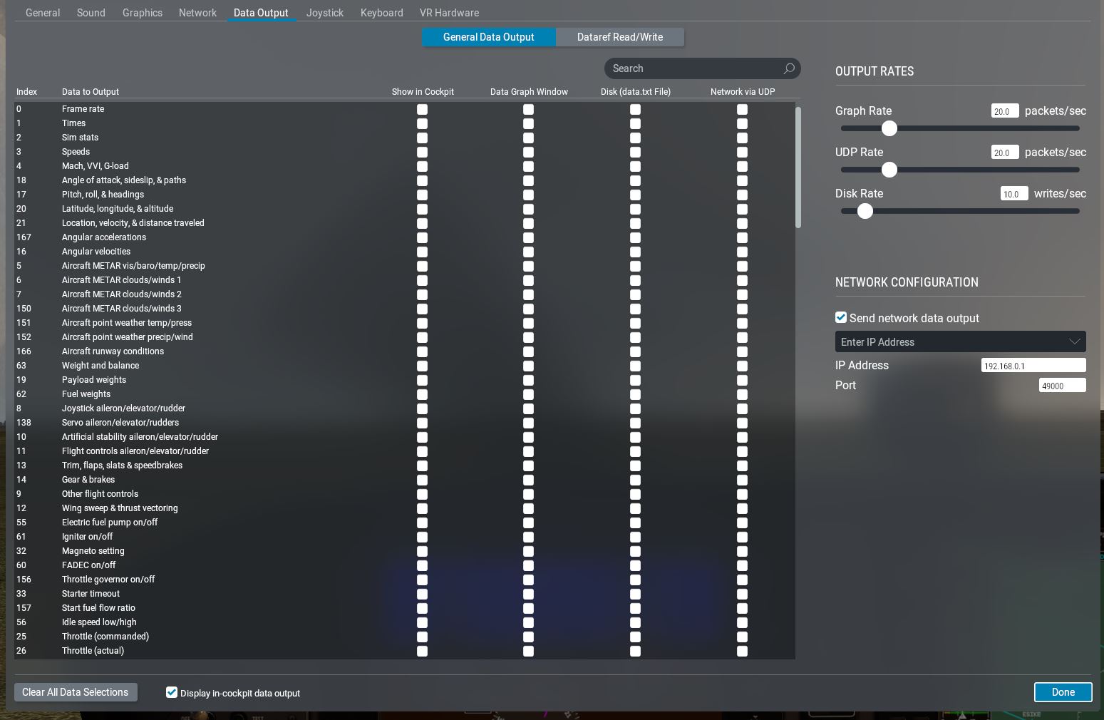

Date Posted: 28 Jan 2023 at 12:31pm
For xPlane 12 you must have 'Send network data ouput' checked on the Settings | dataoutput screen. Apparently this is not a default setting.
Do I use the default 0.1 IP address or teh IP address of my ipad

I tried the xplane plugin and the air manager thing but neither worked for my situation (It would grab the course for the first couple of waypoints but then forget them and would be stuck at 000 and unable to move it with the CRS knob)
But im using something different than the training app, Im using a real IFD550 that avidyne gave me some test software that integrates it into xplane (It's mostly complete but the guy who wrote the code isn't there anymore) I'm also using air manager and that's a bit of a nightmare in itself- it seems almost every HSI/CDI instrument has at least one glitch so I'm trying to build just one or two nav instruments that are capable of displaying both VLOC ILS and a GPS LPV.
I'm not a coder at all but I've been able to fumble my way through a couple of things. I'm trying to get to the stage where we are the first in the world to get an avidyne IFD in an FAA AATD certified simulator. Would you (Or any other code savvy people) be able to help me?
Posted By: ricardo
Date Posted: 16 Jun 2023 at 10:53pm
holy cow .. that is an awesome setup.
i would like to help, not sure i can .. but let me know what i can do.
they (avidyne) must have used different code to connect the real deal to xplane vs the trainer.  (otherwise the fix i amde might have worked right?)
the way i debugged the trainer was i i watched the values of the data refs as i flew around with the GPS controlling the AP and took note of the problems when it lost control of the AP ..  when i found the problem pattern i was able to override that pattern with the air manager instrument.
i’d think you would need to reverse engineer how your IFD is communicating with xplane (is it the using those same data refs that i found or different ones?) .. and perhaps find a simple way to make it work.  i’m no plane plugin / air manager developer, so there might be better ways to do this.
wish you were nearby (i’m in WA) .. would love to see that setup you have and help.
