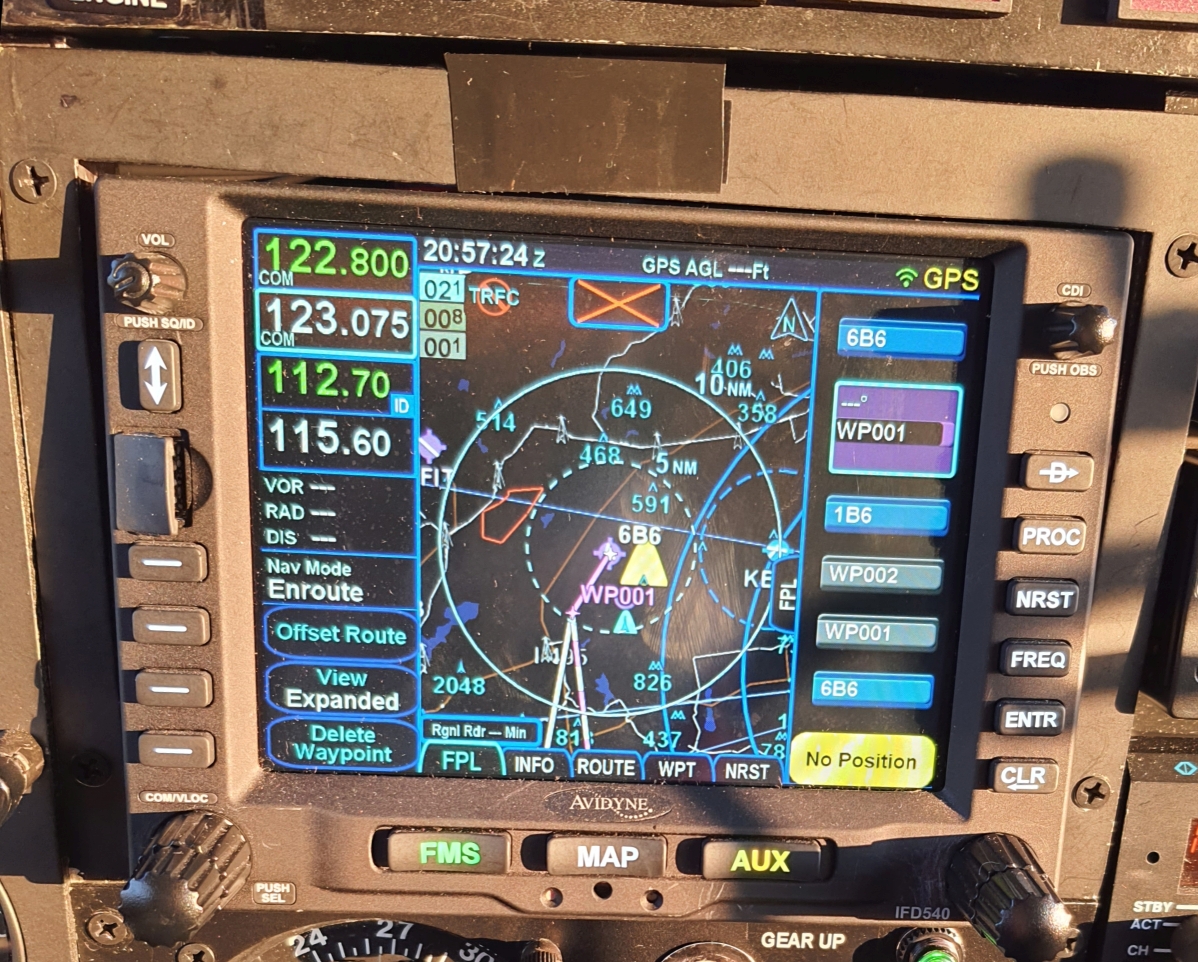

Do others get  No Position messages a lot?
I have always gotten them and although the 10.3.1.2 software seems to help, I still see them.
In this picture, it's happening on the ground though they happen in the air also.  I've never had one
happen on an approach, but I suppose one day it will.

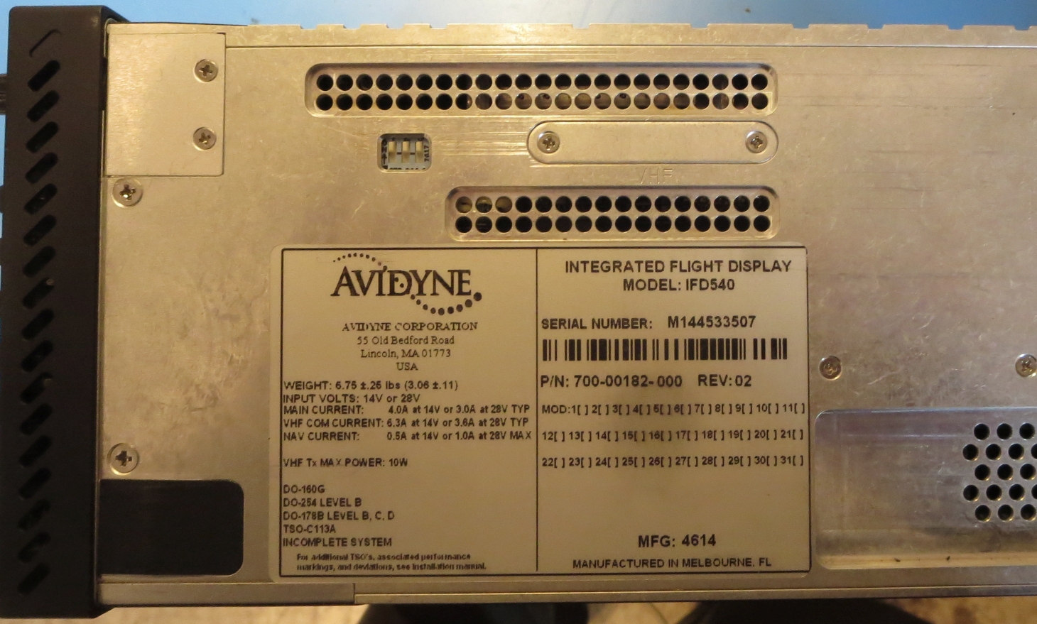

This tag says REV 02.  Does anyone know what hardware rev is current?

Do either of you know what hardware revision you have, or the manufacture date?  Mine I think is week 46 of 2014 from MFG code in the upper picture.
