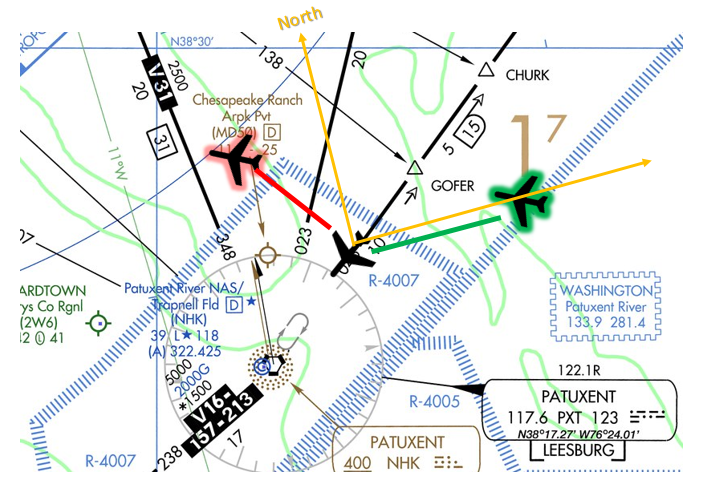

I actually thought about what I saw more last night, and I don't think the algorithm that is painting the traffic for the MLB100 (either in that box or the IFD) is using ground track or heading information, instead it assumes the heading or groundtrack to be North at all times.
For the traffic I visually saw opposite direction on the same airway 1,000 feet below, it was shown on the IFD at my 6 o'clock position moving to the 12 o'clock position.  In other words it was backwards.  Well I was on a ~180 heading on that airway (V29 near ENO).
Then when I turned from 180 to 226 to V16 over ENO the traffic panned across the map during the turn.
Finally near PTX heading 226, I saw traffic on the IFD at 3 o'clock at 10nm.  PTX approach said it was military at my 7 o'clock 10nm.  Well remove 226deg from 90deg and you'll end up with roughly a 7 o'clock position.
So I think the position relative to the nose is correct assuming the aircraft is on a 0deg heading at all times.  So if you always fly north I think the traffic position will be displayed correctly otherwise it is wrong.
I did try all the various map views on the IFD yesterday and the traffic always stayed relative to the planes nose (i.e. made no difference on traffic display).  Finally I have heading information going to my IFD (via HSI Synchro) and normally use the heading up mode.
Avidyne or David you have any ideas on this one?

That's an interesting theory. One I haven't heard before. I suppose a little for flight data and experimentation would reliably prove (or disprove) its veracity.
I will ask some people I know, and see what they say.
Again, the issue has not presented itself in my airplane, so I can neither confirm nor dispute the theory.  (And I'm down for maintenance right now anyway, so more flight experience is not available to me).

No problem.  Just so everyone can visualize it I put this diagram together.
For my N/S case where it's pretty simple to visual, it doesn't answer off-axis uncertainties.
The Pax River case does answer all off axis uncertainities.
For the Pax River case:
Red is what I saw on the IFD map (3 o'clock).  Green is what was reported by ATC (7 o'clock) and the true aircraft position.  If you then visualize the plane flying north instead of along the airway, the 3 o'clock position would have been correct position relative to the aircraft nose.

I can confirm I am having the exact same issue with our MLB100. Traffic position remains static on the display regardless of which direction the plane is heading. (i.e. always thinks it's on a 360 heading). You can confirm this on the ground by taxiing and turning the plane 360 degrees and noting that the displayed traffic never moves. My avionics shop is in communication with Avidyne and my understanding is that they are diligently working on it. We also have Skywatch on our MFD so we can compare the true aircraft position with an independent traffic source to confirm this is an issue.

Just got a report from my avionics shop this is a known issue to Avidyne.
They are working on new software and a SIL will be issued shortly.  I was advised to turn traffic off.
So my question is it an IFD issue or MLB issue?
In other words will the delayed 10.1.1.0 have the fix or some other later fix needed 10.1.2.0?
Is there a work around (i.e. take IFD out of heading mode and put it in track mode)?

Thanks Roltman
I suspected that something like that was going on
Only way it would work would be to fly north always
I think IFD540 map mode will not help.
I saw the issue in north up map mode

My sources also confirm that your hunch was correct.  This is a recently identified issue, and a software that addresses it has been written, and is in testing now.  It is a minor software change in the MLB, so it should have no affect on 10.1.1.0.
